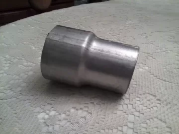

Get one of these at your local speed shop [Hearth.com] OAK hook up
