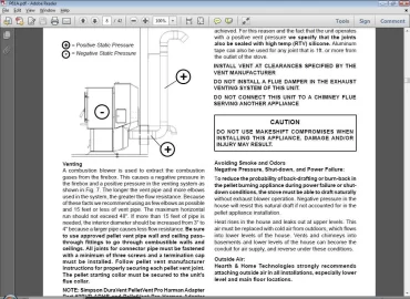

I know that this picture is from the manual from my pellet stove, but I believe it to be a good diagram showing what happens with positive and negative air pressures within the home. If you utilize an OAK, you will force hot air out of the home. If you use air from within the home for combustion (no OAK), you will draw air from outside to come through any point where it is possible that air can penetrate the home.
I looked up the manual for the TL200 and did not see this type of explanation for an OAK.
I think you're reading to far into it..over analyzing it.
If what you think is true why would any stove manufacture even put a OAK connection on their stove?
With a OAK you would think the stove would be a sealed system. Combustion air coming in from outside and exhaust air going up the flue.
In other words..static, except for the stove heating the house.
I don't have a OAK or a need for one. My house is not small and air tight.
I did not have the same stove, but I did have an outside air intake to feed the stove rather than pulling air from inside the house. The outside air feeds combustion and then goes up the chimney and not into the house. None of the air from the OAK entered my house - nor pressurized it.
For my stove, installing an OAK eliminated problems with cold starts. I have no problems with draft when the chimney is cold, even on mild, rainy days. I ran the stove without an OAK for a year or two and filled the living room with smoke more than once. I have the same stove in our basement without an OAK (too difficult for me to install). I have to burn some paper in the clean out of the chimney to get a good draft started when the chimney is cold. The only disadvantage of an OAK is cold air entering the stove when your not burning. I stuff insulation in the stove pipe and outside vent during the summer.
