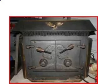

I'm looking at an Oak Ridge insert, anybody got anything on this heater ? I can't bring anything up on it, here or google. EPA approved ? I hope the photo works, my first one.

Late 70's or very early 80's steel box....not much different than the hundreds of other similar designs from back then.
No way it is EPA approved - those standards didn't exist back then.
In other words, depending on your choice of words it is either a Smoke Dragon or a Classic.
I know this is resurrecting an old thread, but just wanted to say I own one of these. It was made in 1982 by a subsidiary of Lennox.
It is most definitely a 'smoke dragon' but I can get this old beast burning quite well with a 25-ft two-side exposed dual-flue masonary chimney with no direct connection.
Yes I am most definitely on the EPA no-no list, but after the initial loading time, leaving the door cracked and air controls wide open until logs are charred I can get a 10-hr burn time from a full box of seasoned oak.
It was full of creosote when I bought it from CL for $150, but one good hot burn of seasoned oak and she was like new.
It's built like a Sherman tank, and about as enviromentally friendly as one :)
