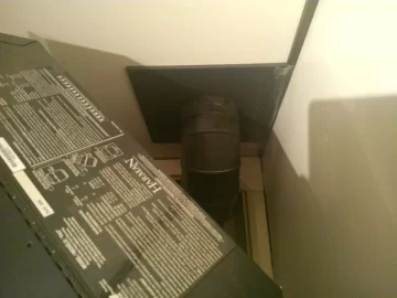

When my Harman was installed, an OAK not installed as I was told I did not need one. Last night I discovered where my stove is pulling air from: outside! Attached is a pic of where my stove is vented thru the wall. They had to trim the right side of the wall plate (the black square the vent passes thru) to fit up against the corner wall trim. I found last night that cold air was rushing through the gap between the plate and the trim! The last few days my stove has been set at room temp 70 And the stove had been maintaining this.
Last night I put a piece of cold weather tape over the gap. My fire was not as active - although I would not call it lazy - and my actual room temps were 66 and 67 this morning even tho the stove was still set for 70. (Granted, it was 20 degrees out Last night, but still...)
I took the tape off turned up the room temp and the stove is now merrily working with a tall wall of flame and working to heat up the house.
I had questioned Harman about the need for an OAK thru an email and was told "The only time outside air is needed, is if your home is extremely airtight which would create negative air pressure inside the home. in this case the stove would not operate properly. You would be seeing soot build up inside firebox and would have a very lazy flame, and in most cases the stove would shutdown. If any of the above mentioned issues are occurring, I would recommend having your dealer install an outside air kit."
None of these issues have happened. But not sure that the only reason is because of the cold air around the plate!
Now - do I need to demand installation of an OAK this summer?

I've never been convinced on the whole OAK argument but having said that, I would tinker with your theory of that nice cold air sneaking around your wall thimble by removing and replacing the tape at key times as you go through the winter season. Furthermore, if that exhaust is on an outside wall and it would appear that it is, an OAK install would be a slam dunk. They even make a thimble with the OAK inlet built into it.
Air will come in somewhere. If you didn't have that it would be coming in through your doors and windows and bathroom fan. If I were you I would go get the parts and install it now. Will take you about a hour to do it right and you get the benifits of having it done correctly.
A stove is going to draw air through it for combustion this air must be replaced, since no air is created inside the house it must come from outside. It will get the outside air from every small (or not so small) penetration of the houses shell.
You can choose exactly how the stove gets its air.
I made my choice before the stove was installed.
This is your choice to make, all that'll you'll get from the dealers is the result of only caring if the stove will be able to get enough air so you won't be calling them up wondering why the stove burns like crap or that they loose the sale over a few dollars of pipe costing more than the next stove shop quotes you.
A big hint is that your stove maker recommends one, there are even a number of stoves that require one, in fact there is one maker that requires one for all of its stoves.

Melissa, by "demand", do you mean they should install one at no charge? Highly doubt that'll happen. However, I would install one. If it's not too late (thimble hole cutting wise) the Harman kit is very nice. Other manufacturers also offer thimbles with integrated OAK's that might "cover" your existing inside hole and outside trim/flashing, etc..if need be.
From an initial investment point of view I can MAYBE see where someone could make the argument AGAINST an OAK. Say the OAK costs $100-200 above and beyond the cost of the base installation fee. Well, $100-200 worth of pellet BTU's to compensate for the drafts caused by the lack of an OAK would last a long time. Hope that makes sense.
You gotta look at the big long term picture here. Saying "I'll just burn more pellets to offset the drafts" is wasteful and plain silly. I'm not saying this is YOUR reason. Just commenting on the people who believe this.
Ultimately, I can't understand why there is ANY argument against installing one. As MANY others have stated, it's a very basic common sense concept that I won't bother repeating. I wish someone would tell me a legitimate reason against using one.
No, not at all. I know they would not do it free of charge. By demand I mean I have asked twice about whether they were sure I did not need one ans was told I did not. That my stove would get air from a bathroom fan - which I do not have - or a kitchen fan - which I do not have - or a dryer vent - which is in the basement in another area of the house. I have had to put plastic on my windows due to cold air seeping through the windows so there is no air for the stove there.
Are there any other dealers in the Bangor area you could check with?
I think the most interesting part about this thread is that Melissa said she e-mailed Harman and they told her, "The only time outside air is needed, is if your home is extremely airtight which would create negative air pressure inside the home. In this case the stove would not operate properly." Because I always thought Harman -- the manufacturer, that is, in its manuals and in my e-mail with them when I had the same question -- always advocate for the OAK. It's the guys who sell and install them that almost always advocate AGAINST OAKs. I have one by the way, terminating in the same flue as my exhaust (but well below it).
Thank you. I thought this was interesting as well. My manual recommends one, which is why I brought it up to the seller/installer TWICE. and twice was told "not needed".
