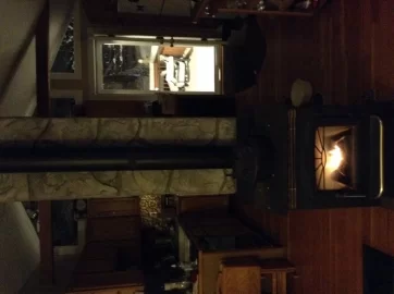

Unfortunately, the stove is in the middle of the room. Going to try to attach a photo. Thanks for the clear thinkers. Think it will come out above the snow line. Many times I get ideas out of nowhere and need them to be junked.

lovely room.
