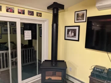

I just installed my wood stove. Fired her up and we are well through the break-in schedule.

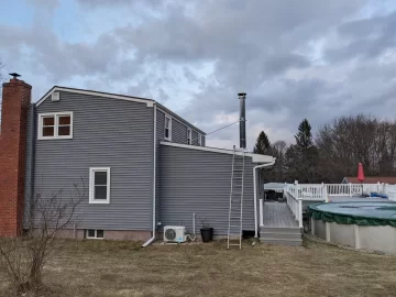

Chimney is 4.5' of double wall DVL with 2 45 bends and 9' of class A (no damper).
Stove is a US2000 model.
Installed in a cape style house, in a back sunroom. Windows are all brand new and sealed well.
Right now, no OAK is installed on the wood stove.
I am experiencing a slight smokey smell independent of throttle air control. It appears that the more roaring I get the fire, the more smokey the smell gets. No issues on startup or shutdown. I tried putting a 360 degree light in the firebox to see if there were any gaps around the seals or in the fire box and I didn't see anything.
The Smokey smell is tolerable but it's at the edge of tolerable. Today I tried to crack a window near the stove but had to leave so I can't tell if that will help yet.
I suspect my draft is weak, I think that is reasonable to assume. Do you think an OAK will help? I have all the stuff ready to go but haven't installed it yet.
I also have another 3ft section of class A coming. I want to get the smoke well above my roofline. I know this will improve the draft too.

If it’s wood smoke the extra 3’ of chimney will help as you should get a stronger draft and that will reduce or eliminate smoke spillage from the house.
One other source of smoke smell, is when I crack a window. The chimney exhaust rolls over the roof and in a open window.
