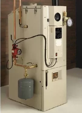

Wow, looks like the Harmon HYDROFLEX60 Pellet Boiler is a good way to go! Heck my oil boiler does not have battery backup!!
List price is $4999.00 so it may be quite a bit cheaper
Features
* Patented Pellet Pro Feeder
* Patented Pellet Pro Burn Pot
* 120 VAC
* 90% + Efficiency
* Small Footprint
* Faster ignition & recovery for quick response to heat needs.
* 14 spiral baffled stainless heat exchanger tubes increase efficiency.
* Electronic Temperature Control
* Front door with window for easy ash removal, burnpot access and fire viewing.
* Outside Air Temperature Sensor
* Dual boiler water temperature and presssure gauge
* Pressure Relief Valve
* Refractory-lined firebox
* Fiberglass insulation surrounding the entire unit
* 3 inch pellet exhaust
* 3/4 inch water lines
Options
* Wireless Thermostat
* Direct Vent Wall Passthrough
* Bulk Hopper (1400+ lb hopper capacity)
* Outside Air
* Battery Back Up
