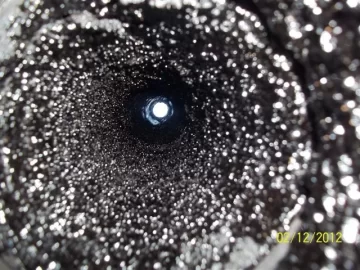

Yes, I made it bigger, not to get more heat out of it as such, for greater ease of use. I "could" have done a ten hour burn as you say, but why should I not enjoy the same benifit regarding the long burn times without having to re lite the stove? Poisoning, I am not doing so, think about it, very low burning yes, smoke off the logs yes, most of it condenses right on the (cooler) insides of the stove , heavy thick black tar that just nicely burns away when I next have a hot fire, You can burn it up with a cat or a hot fire. what does go up the chimney does not go far up 4-5 feet and condenses there,There is not a lot of heat going up the chimney as evidenced by where I build up creosote, and thats good as I clean the chimeny about every 6 weeks-2 months and knock the creosote right back down into the stove to be burnt up.
Wasting heat is the last thing I am doing. We see -40 every year (though this is the first in my memory we havent) The heating season is 6 months long, I have never gone over 3 cord of birch, less with tamrack I am running one tight ship on my fuel use, wasting heat is a expression that does not apply. The one pick is of a extension for ontop of the stove that has a hinged door. this door swings out letting me check the condition of the chimney without having to climb on the roof, the next pick is with the door open, and looking up, and out just before I cleaned it. note where all the creosote forms at the stove end! not up high going out the top of the chimney. I am keeping my heat in, and (mostly)[Hearth.com] Okay, I am really torn... recovering the smoke deposites that you are imagininge going in the air!
Well eddy you are smoldering bad with the way you are burning..it is evident in the pic.
No way you are burning that off with the next hot fire..no way unless you have a chimney fire, which imo is not out of the question with those deposits.
I have no idea what is going on with that top pic?
You have to read what I posted, and not just look at the pic's....I did not say I burnt it off, I said I cleaned it off at that point (swept the chimney, not tried to burn it out, Swept in back into the stove.
eddy, listen up. That is a dangerous accumulation of creosote. Good that you cleaned it, but it's evidence of a problem. Sorry to say tha you have too much stove for the home and are heading for problems with the current mods. This is a bad plan getting worse. In the least, put the cat back in.
What happens when you get this amount of accumulation and then a sudden blizzard hits with cold temps? You will open up the air, fire up the stove and that stuff will ignite. It isn't a question of will it happen, just when.
Ah..I did read it too fast ..my bad on that.
Put the cat back in and try it again.
Pretty sure you won't have to clean as much..crack a dang window or door if it gets to hot..lol.
