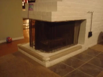

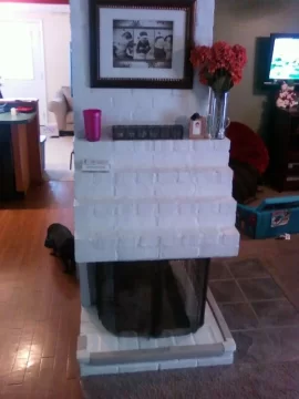

Okay...so which insert would you go with?
not sure if you looked at this but the vermont castings montpilier has a flush style front to it as well.it does extend about 2" from the face but can have a riser put under the front to support it
for yours the problem with the firebox floor being raised a bit is that some blowers rely on them being somewhat supported from below as well.
regencys 2400 and 3100
hamptons hi300
and some of the ones that extend onto the hearth ,which you dont have leave the insert somewhat unstable with the door wide open when loading.
just some things to think about before a purchase while masonry work is going on
we have taken some freestanders and trimmed the legs down to fit if heights are close and some bucks can be installed as inserts or free standers
i got an idea for you. how about a avalon olympic insert but dont use the surround. make the blower sit flush with the front edge of the existing brickwork. keep the rear and left side screens in place.
this unit can be used as an insert or freestand so the finish on the sides is just as nice as the front.
it will just fit for your height an not have much of a gap for you to need the surround. the blower bolts on from the front under the door and ash lip.
does more than your sq footage, huge firebox, and is made by travis industries the same maker of some of the others you were considering.
If I were you I'd get rid of the brick on the floor and try to get a freestanding stove to go in that open space! You will get twice the heating with all the way around open space. No brick around the back, just the back of a beautiful front/side loading stove. I'd kill for an open space like that to put a stove in. Pure heat all the way around!! Plus you can get a bigger stove that will heat your entire house even with extreme weather. You have to be crazy to close that in and put an insert in there!

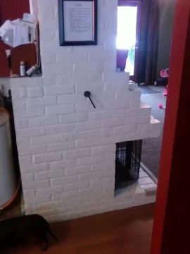

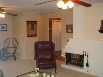

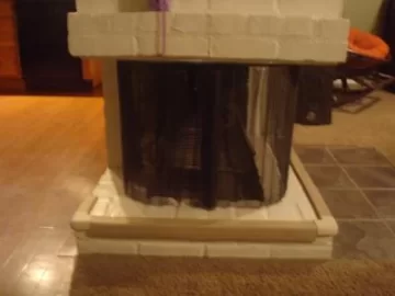

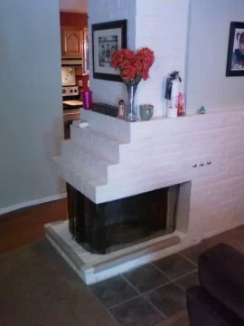

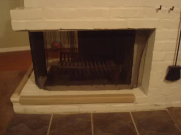

Baja, the avalon idea won't work because of the improper hearth clearances on the back and post side of the fireplace. It would have to be bricked in. In terms of the free stander (much modication to the hearth), i've only got a 33 inch walkway into the kitchen. Don't know if that meets hearth clearances. I was out to Thewoodburners.com (stove shop in Hatfield, PA). These people are awesome. By far the best dealer I've come into contact with regarding my tireless effort to heat my home with wood. You can tell when you're working with good people. The only drawback to their shop is a lack of wood burning insert models on the floor. Their prices are also better than the other shops I've been to.
If you're considering the Declaration (2 doors) I'd get one fast as next season's model will only be a single door but with a larger viewing area. My next step is to have the installer and mason come out at the same time to gameplan. My wife is now annoyed and has even called me "obssessed" regarding my research. Lol...I just told her to deal with it. Talk to you guys later.
More pics of the situation. Note the the 33" walkway into the kitchen. The free stander just might not be feasible.

I still think your original idea of installing an insert would be the easiest.
You could go go with the bay window Osburn though, and it would fit according to the dimensions you posted earlier.
(broken link removed to http://www.osburn-mfg.com/product.aspx?CategoId=7&Id=245&Page=spec)
EDIT:
Another option to consider is the Pacific energy "Super" insert, it looks like it'll fit.
2.5 cu.ft. firebox.Also, with the easy-to-remove baffle, it would make chimney cleaning a lot easier.
(broken link removed to http://pacificenergy.net/pacificenergy/super_insert.php)
If you download the brochure, you'll see that it fits your fireplace.
So what did you decide here? If you can't fit a freestanding in there, have you thought about trying a decent looking insert without the surround, like somebody suggested above? Avalons, Lopis, etc look pretty good that way. Here's a thread with some images:
