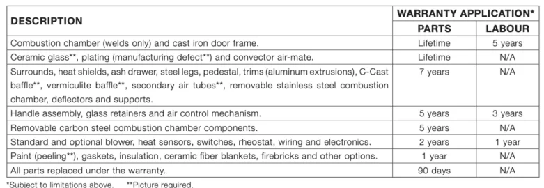

The Empire looks like a variation on the Drolet 1800i with a C-Cast baffle instead of vermiculite. I don't see why one would pay extra for the dealer warranty when the stove's warranty covers most everything.
