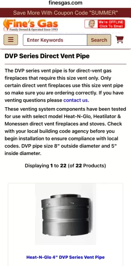

Try here:
  • [Hearth.com] Old Heat n Glo DV Pipe and fittings
Thanks! Unfortunately, that's for DVP pipe (the new standard) and not the old DV pipe - which is slightly larger and the two are not interchangeable and you can't go from bigger (DV pipe) to smaller (DVP). No one makes a converter for that very reason. I have tried everything I could glean from web sites and contacted Fine's, Hearth, Heat n Glo, Duravent - and get the same answer - I have to replace the fireplace and redo the DV pipe with DVP pipe. The only option is to find someone that has done exactly that and may have some DV connectors and pipe for sale. I have also tried eBay without any success. So, if anyone has old DV pipe parts laying around, please let me know. I also thought about taking a section I have to a metal shop, but the ones that I have contacted won't fabricate something as it would not be the original parts and they don't want the liability.
