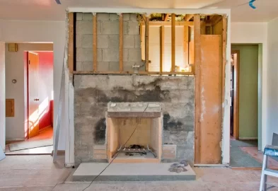

The heatform came out with no problem. Used a 4.5" grinder, cut in sections... The chimney stack, directly above, stayed firmly in place...Was not resting on heatform. Hired an experienced fireplace mason for this..did not want chimney tiles to come crashing down.
We had the firebox and smoke-shelf rebuilt. The fire box, priviously on ground level was raised 5" to make fire more visible/interesting and allow for a hearth. That was a bigger job than expected.
We had planed to add an insert, but the beauty of fresh fire brick gave me pause... The pictures show where I'm at now.
The walls surrounding fireplace were uneven, so I will add a perfectly level new wall... The design plan is to go with a Modern look. It's probably going to be a dark grey tile (almost black), ceiling to hearth all one color. Hearth, a flat finish dark granite.
Please Note: Looking for feedback!
When I removed the plaster wall I found a cubbyhole area (above firebox). Now I'm trying to incorporate into design. It might make a fine wood storage area but sort-of an odd place for it?
We want a modern clean lines look for whole wall.. having a hard time picturing how to make the wood storage area work. Any design, or functional idea would be very welcome.
