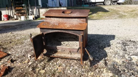

I have been gifted this stove by my sister in law, they used it in an old house they had, and rented after they moved out, it sat up in the fire place. I think the storm collar leaked after the last tenants, and thats where all the rust came from, its not lived outside except the last few weeks.
My question is this. Restoring old stoves that are cast iron, is that process any different than plate steel? I havent picked this thing up yet, but it looks like its heavy. Doors look to be 5/8's or better, it looks beefy. Its going to heat my 30x30 shop i recently got in the dry finally. Already had the triple wall pipe and everything i need to go through the roof. I think all i might need is some pb blaster, a wire wheel brush, couple other smaller hand brushes, clean off the bp blaster with mineral spirits or something, and then hit it up with some stove paint. Never restored a stove before. I'd also like to hear any concerns or worries from seeing the stove and its condition. Reckon it would do any good to build a fire in it to loosen everything up, then clean it up?

Well first off that is plate steel not cast iron. And it is in really bad shape personally i wouldn't waste my time on it. It is a very basic stove to begin with and in that shape i don't think it is worth the time or effort. But that is up to you.

i can see how the way i asked about the usual cast iron stove cleaning, might look like i was under the impression this was cast. I was trying to ask about the differences between cleaning a steel stove as opposed to cast. lots of posts i saw talking about cleaning cast, not so much when it comes to steel. thanks for the input.

It acts just the same wire wheel or sand blaster then high temp paint
just had a guy quote me 150 bucks to sandblast it and powder coat it. That may be my best bet.
It will get to hot for powder coat.
he said 1200 paint. You saying a powder coat application cant withstand those temps?
Not any i have ever seen. There are several chimney companies powder coating things now and none of them will do connector pipe because it gets to hot.
i asked him what the paint was rated for, he said 1200F.
Was that paint or powder coat? I am sure if there was powder coat out there that could be used stove manufacturers would be using it. It is much cheaper and easier to do than enamel. But hey give it a try let us know how it works. I will say that powder coat will really show all of that rust pitting I think a flat finish would look the best considering the condition of the stove. And it would cost much less
I just looked and say there are 1200 degree powder coats but a stove top can reach that. It shouldn't but it can if you let it over fire. I personally wouldn't spend $150 to refinish that stove but that is up to you.

Im pretty sure he meant powder coat, because i specifically asked if the powder coating would hold up to the heat, thats when he said 1200F. Unless we just misunderstood one another. I'll be sure to ask him and talk about the concerns of it peeling. It may not be until next week before i go get it and take it down there. i'll post pictures either way, at least i think i'll have him sand blast it, if i end up painting it myself. if it shows some pitting, thats ok with me considering where its going to live.
Where is it going? If you don't care what it looks like really I wouldn't spend much on it just wire wheel it and paint it.
