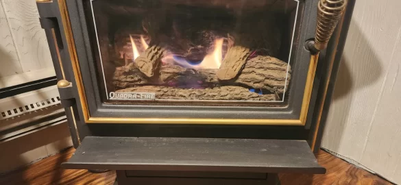

Hello all,
I have a 1992 Quadra-Fire / Aladdin gas stove. It is leaving a lot of soot on the logs in the burn box where the flame is emitting around them. I was wondering if there is a cure to this. I cleaned out the inside which had a bunch of soot (loose) on the inside under the gas manifold/fake logs. It did not change the logs having a soot build up. I did read maybe the flame is too high/hot? I adjusted the knob on the control panel to low, it operates fine. It has the blower option as well. So any way thats it, just asking if a part may need changing or is it the flame is too high?
It works good, puts out good heat. Also is there replacement fake logs available? Please see pics for placard w/ info.
Thanks,
Mike

What type of gas are you burning, LP or NG? If it’s LP, try to locate your air shutter adjustment & open the shutter all the way. You may lose some of the realistic looking yellow flames, but it should burn cleaner.
NG, so it would not have a shutter?
It should have a shutter, even for NG. The air shutter is used to adjust the Air-To-Fuel (ATF) mixture & if it gets shut too much even burning NG, the unit can soot. Check your owners manual, if you have one. It will tell you the proper setting. If you don’t, there may be one online.

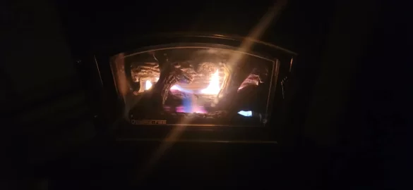

Indeed it has one. Pls see pics. It is in wide open position. Is it too much air if that is the case? Should I close it a little? 1ST pic is of the shutter valve. 2nd is pilot light/manifold, third soot on the logs after short usage.

What color are the flames when the burner is on? They should be blue at the bottom & yellow at the top. A wide open air shutter shouldn’t give you any sooting like that. Is it possible to move the logs further from the flames? The flames should be CLOSE to logs, but not hitting them.

Welp, the flame looks orange to me at the top, def blue at the manifold. See pic on initial post. Yes the flame was going right onto the log, that is where the majority of the soot is(see pic 3 from yesterdays post). I will try to move them out of the way of the burner and see what happens.

Logs position very important in regards to sooting up, they need to be in correct position. Were they moved recently or did anything change in its operation? DAKSY is a very good ref for gas info, good luck.

stovelark, the manual was correct for the logs. I adjusted them and am monitoring for soot but do not see any new build up. One of the logs was over the manifold. I think it is the right manual, it has the same model number?
