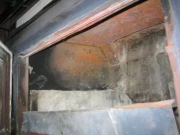

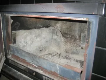

I'd be curious to see a few pics of the inside of the insert (once you get the ashes cleaned out).
I'm talking with a tin knocker who's going to give me an estimate. He'll probably use regular stove pipe steel. Will be a problem vs. stainless?
Here's a few pics of the inside. Thanks for looking

My stove has a similar output, just get a rectangle to round boot (http://www.chimneylinerinc.com/specialty_parts.htm) and connect to a liner.
Edit: guess we posted at the same time. From you pics you posted you could fab a piece of ss to put on top to fit the boot, or go with a connector from stovepartsunlimited, part # is 9S31214 for 8” x 14” x 3 1/2” Stack to 8" round connecter.
