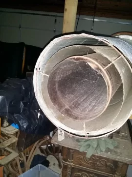

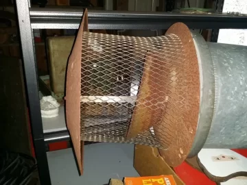

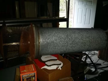

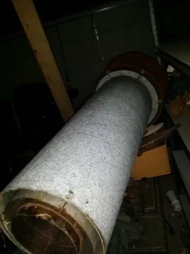

attached are images of the pipe I plan to use, no sticker. Also I scoured the door frame and inside the fireplace but there is no model number to be found. Once again, outside pipe is 14 inches and inside pipe is 8 inches. And I guess I'm looking for a new cage top as well since this one is so rusted.

That is an old Preway fireplace and chimney. Preway went out of business around 1982. Parts are long unavailable, unless you can find them second hand. IMO, it's decision time. Most here would recommend removing the fireplace, wall and chimney, and starting from scratch with a new hearth, modern freestanding stove, and new insulated chimney. Big project but worth it in the long run
