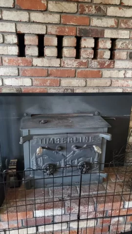

Hi all,
I have this old timberline insert in my house. I've been using it for 5 years or so mostly almond wood (in-laws own a ranch, get it for free), had the chimney cleaned and inspected, no issues, no buildup so its burning clean.
I was reading some places this morning trying to find a way to make it more efficient. There is no blower (maybe there used to be, no clue). I started to think it was inefficient this month, I drove to pickup a full bed of the almond wood 3 weeks ago and today its almost all gone. Before that I was just going off large piles I had outside so never really paid attention (plus I use it more often now since I have young kids and want to keep this side of the house warm).

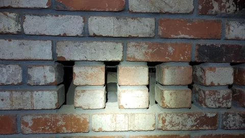

Posted some pics hopefully it helps. Not quite sure what the brick venting above it is for please let me know if you do, there is metal in there with some cyliner spots welded in.
I usually run it all day, throw a massive log on a night and close the vents down, in the morning I can throw some smaller stuff on top of the coals and let it start over again.
Anyway posted here to see if someone can give me some info on this, is it worth replacing, is it fine as is? I was reading some forums this morning and seems these older units have a bad reputation compared to the newer stuff. I have only had issues with smoke once, just a few weeks ago it was very windy and was blowing smoke back into my house, so bad that I had to remove a log from the fire and close all the vents.
thanks for any help

Given the age of the stove the odds are there is no liner on it. If this is a slammer installer that is depending on the seal of the surround then at least that should be addressed by adding a full stainless liner.
I personally, would update it to a modern stove. It will burn less wood cleaner, take a smaller 6" liner, and will provide a nice fire view.

Slammer installs without a liner are no longer allowed. I am guessing that the old Timberline would need an 8" liner which is more expensive than 6". Most modern inserts take 6".
The main hearth forum has threads and reports on almost all inserts. There is also the Ratings section in the top menu bar.
Measure up the fireplace cavity, front and back. If one will fit, look at 2.5 to 3 cu ft inserts by Drolet, Osburn, Lopi, Pacific Energy, Ironstrike, and Napoleon. In catalytics, look at Blaze King, Kuma, Regency,
