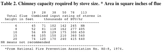

The Fisher double door is a large stove, which poses multiple problems for a smaller flue. First, there is the simple question of the chimney capacity in BTU. Every major chimney company publishes a chart as the the capacity of various chimney sizes.....and an 8" chimney is almost DOUBLE the cross sectional size of a 6" chimney (in sq inches).
Then there is the matter of the double doors on the unit.....any unit with larger openings requires a larger chimney in order to sweep the doors clear of smoke when loading and starting.
After you are done with those two things, you then have the actual temperature of the chimney. A 6" chimney venting the same products of combustion as a 8" chimney will get much hotter. I would assume that the triple wall chimney mentioned is probably older, which means it is not even up to current temp (HT 2100) standards.
An example of a capacity chart is enclosed........keep in mind that the chimney capacity must equal the MAX. potential input of the stove, and I would bet that a double door fisher burning in the lab could get up to 150K BTU plus.

  • [Hearth.com] old unlisted vs new unlisted stoves
