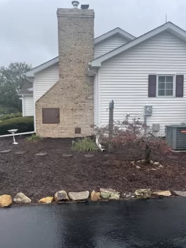

I posted before about this but didn’t get much response. Seeking advise from anyone who’s had previous experience w this
Back in November we replaced an oil boiler with a condensing boiler, no longer needing to use the chimney flue. The flue was sealed at the bottom and the condensing boiler hung on the wall over the opening, making it no longer accessible. The flue has a rain cap on top, allowing for ventilation at the top.
There’s no visible evidence of anything so far, but is there a real risk of moisture buildup in the flue or am I worrying for nothing? It is vented at the top through the rain cap. My major concern, and where I’m kicking myself in the butt, is allowing the boiler to be hung over the bottom flue hole that was sealed. Now it’s no longer accessible from the bottom end, which is a little unsettling.
Is there a cleanout below the blocked-off flue hole?
There is not. The blocked off hole is a short horizontal clay tile thimble that connects to a vertical clay tile that runs to the top. Nothing below it. It’s a 90 degree angle
Is it an interior or exterior chimney? If it is an interior chimney, just cap off the top.
Its exterior. The door u see on the bottom right is an ash Cleanout for the other fireplace flue.

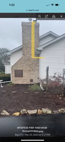

No basement. And the crock from the old boiler runs 90 degrees horizontal, then goes straight up, like the yellow line shows. The only solution I can think of if we ever needed to access it (besides taking the boiler down), would be to bust a hole in the outside brick. Of course, that would be a crap show. So far it’s been good, but we also haven’t hit the humid season.
