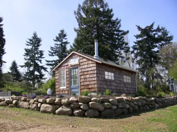

We sort of did this by recycling large picture windows and some side windows and doors that were removed from the house. Truth be told I would have done things a bit differently with what I have learned, but it does work after a fashion.
Just what I am looking for...
What things would you have done different? I would prefer to learn from your mistakes lol.

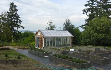

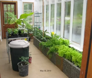

Our greenhouse has an insulated cement floor. The idea was to create a heatsink to retain heat. If I did it again I would have a gravel floor and soil beneath the bed(s). The south-facing roof is double-wall UV plastic which is ok, but it knocks down about 20% of the light. It overhangs the vertical south windows by about a foot. This creates a shadow line that reduces light to the bed right in front of the south windows during spring and fall due to the sun's angle. Had I sloped the south windows, more light would fall on the beds.

First, that is a wonderful greenhouse. I specifically like the cement planters for heat retention.

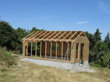

Thanks. it is pretty in spite of my design errors. Yes, just the sill boards are PT. The rest is conventional lumber. From the north side, it looks like a cabin and someone could turn it into one if desired. The interior is insulated with 1.5" foam board between the stud cavities. The shakes are old-growth hand-split cedar.

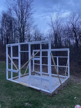

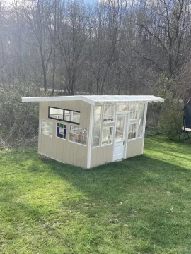

The foundation is almost complete. Just have to glue the last sill boards down. I had to wait on a "go" from the wife on the door location. I also have a start on the front wall, which will be the tallest and have the door in it. My plan is to build the front and back walls first and stand them up. Then, build the roof on. I'm not going to permanently screw the windows in until the entire structure is up and painted. The wife is going to have to scrap and paint all of them before they go in anyway. I am also going to prime all of the boards with Kilz before I even screw them together and do the finish painting while its standing. I will start taking progress pictures and posting.

Finished the front and back walls. I am priming everything before I put it up. I plan on getting my 2x6s for the rafters this afternoon if the rain stops and spending the day tomorrow cutting and painting them.

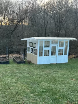

Current progress...
Needs painted, the paver floor and some permanent growing tables. There are some garden plants stated. Just wanted to get it functional and can worry about the details later.

Sweet! That turned out nicely! It will get hot in the summer? What are the ventilation options?
Many of the windows are on hinges, especially the ones up higher.

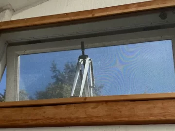

The windows may need screens. I had to staple in screening in my vent windows because hummingbirds kept getting trapped.
I put Baylis Mk7 autovent openers on my upper two vent windows. They have been a godsend in helping keep the greenhouse temps regulated. So far they have been in place for 10 yrs and still work well. I tried cheaper units and they are not worth it. For wood windows one needs heavy duty units. I think Dan Freeman was trying out some German models that I hadn't heard of before. Not sure how they have worked out for him.
