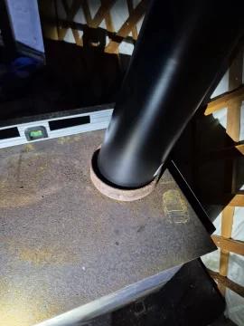

I have what I believe is a Fisher baby bear. 24x18x24 that I'm installing through the wall of my yurt. Is there a adaptor for the flue collar to fit this 6" pipe? How does one determine the btu on this stove and how do I find the clearance neccesary from the stove to the wall? I'm grateful for any help here.

That is not a fisher and it takes 7" pipe not 6"

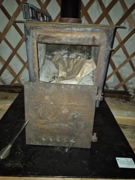

I did post a pic but it didn't upload. I'm just waiting for a moderator to approve that pic. It has a loon relief on the front.

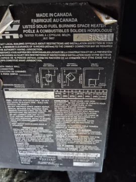

Thanks! Looks like a Century FW250XXX but just below that is 030. So the model number is FW250030
The clearances to follow are shown on that decal. Only thing I can't read is the date of manufacture, lower right corner.
Link to parts and manual
Manual: Century FW250030 Manual
Parts: FW250030 parts

Thanks, I found the sticker and the suggested clearance is 14". Apparently I have to get a reducer for the 6" pipe but I'm not sure if I need to drill a hole through the collar on the stove to secure the reducer.

Wow!!! This is amazing. Thanks so much. It even has the brick pattern. I paid $200 for this. I think I got hosed. The seal around the door was rotten. The bricks are completely burnt out. Even the brackets o. The sides to hold them are corroded. The slider bar barely moves and the spring handle is bent. I'm new to country life and woodstoves. Citified rookie mistake

The slider can be lubricated with graphite powder. Pick up some at the hardware store. Sprinkle it liberally between the door and the slider while working the control back and forth until it loosens up. Put some graphite powder on the hinge pins too.

The door gasket isn't a big deal to replace. The fire bricks are two different sizes and easy to replace. If the fire bricks aren't broken, they should be fine? It's ok if they're discolored. That's just creosote from the wood. Speaking of which, you need to find some really dry/ seasoned firewood.
I can't really tell anything about the fire bricks from the picture.
You can gingerly use some steel wool and clean up the rust on the stove and they sell high heat stove paint in black and other colors. Just want to do some small burns in the stove to cure the paint if you decide to paint it.
Is the yurt going to be a rental place or similar?
Oh and I think you did good for $200- It really just needs to be freshened up a bit. Stoves like that around here go for $500-to $800
Reactions: Aggiemanderson
I dunno, I wouldn't have paid $200 for it. This is a really early Century.
Is there a baffle in it or can you see daylight looking inside up through the flue outlet?

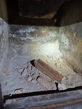

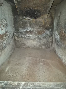

This is the before and after of rhe bricks after I chiseled away at the inside. One of the bottom ones was broken and the ones on the side had completely disintegrated. I think I'll just buy new ones.

Previously I had asked about the 6"pipe that goes into the flue collar. Mine seemed too small but in fact, I hadn't 'expanded' it into the groove on the side of the pipe itself. Rookie mistake.
Now it fits pretty snug male side (ribbed) down. Do I need to secure it some other way as well or does it just sit in there on the baffle?
Also, I bought a supervent chimney cap from home depot but it doesn't come with a spark arrestor. Why? Is there a work around here other than spending $80-$120 on a spark arrestor? Tia. You've been a great help as have others in this forum. What a great group of people. I wish I could meet you in person 😃
The stove pipe should not pass through the flue collar. If it's able to hit the baffle, it's far too loose. This will require an adapter. A 7" to 6" reducer may work. What is the exact outside and inside diameter of the flue collar to the nearest 1/16th of an inch?
