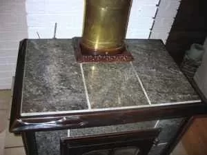

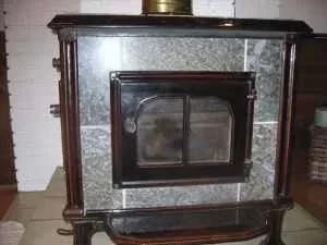

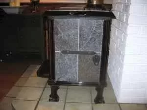

Hi,
I am looking at a used (barely) Hearthstone model (see pics) that the seller calls a "Brownstone". Does anyone know anything about this model? I have not yet seen it in person, but plan to. Based on the pics, it looks a bit like the Heritage (top mount exhaust) or Mansfield (except side door). The only literature I have is what HearthStone provides on their site for their current models. How does this model differ from today's? Is it catalytic?
What should I inspect in the fire box for this model? What else can become "weathered" over time through non-use (barely used by owner - 10x in 20 yrs?)?
Given that there are zero links on the internet for this model, I am going into this purchase with little info outside of what the HearthStone site provides about soapstone in general and their current models.
Thoughts on what a 20 year old Hearthstone might be worth in this condition?
Thanks for any help you can provide.

That looks like a cherry Hearthstone I model. It appears to be in really nice shape. If correct, the word is that it wasn't that great a heater for it's size, but I'll wait for confirmation from the hearthstone crowd.

I took a look at it. It is a Hearthstone II wood/coal model with metal baffle, side and rear plate assemblies in the firebox. It also has a single air flow pipe. Apparently, it was purchased in 1985 and it has hardly been used. It looks immaculate except for a little rust on the glass retention bracket and inside the side door.
If I am going to use only wood in this unit, would it be possible to replace a lot of the metal plate assemblies with the bricks used in the Phoenix or is that idiotic?

Being only two stones deep on the side would make it most similar to a heritage today in size. The legs are like a modern mansfield. It does look very nice for a 20 year old stove, I hope mine will look that nice after 20 years. The inside of the stove is the next area of concern. If coal was burned in this stove then the corrosive nature of the gasses might have been hard on this intermittently used stove. Lots of cold stone mass means a good bit of condensation is possible and may have rusted the steel plate out. I do not know if this model was a catalytic stove but since it is able to burn coal I would seriously doubt that it is a cat stove. In fact, it might not even be a clean burning secondary combustion model due to the multifuel compromises.
If the plate is still solid inside then I wouldn't bother to replace it. They were designed this way and the addition of firebrick won't do much for you except reduce firebox size.
20 year old stoves are not EPA certified and so not legal to install in my state. How about yours? Since they are not legal to install, the value is diminished to furniture level. 500$ tops since that stove is in such nice condition.
