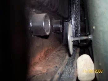

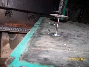

Barnartist, do you have a EKO 60 standard. If so have you checked the alignment on your secondary inlet adjusters latley. I adjusted mine where they needed to go but one of the discs managed to come loose so I had to redo the secondary air inlet baffles. Here are some of my original pics and fixes of the problem. I moved the adjuster screws up close to an inch to properly align them with the inlets.

I did make this adjustment a season or 2 ago as they were off. I have not been in there since I made the primary air arm (so I could manually adjust without cover removal)
I think my settings are close because I am getting a very nice burn at the moment. I am about to go check and see how things look as I am about half way through my burn by now. My tanks are charging very well. I can see this with a wireless gauge.
