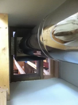

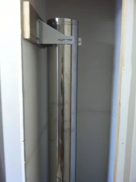

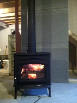

Anyone know anything about Olympia Ventis stove pipe? Any good? Looks really nice, durable. I have a SuperVent chimney and my chimney guy says it's compatible. Anyone have any experience with any of this? If all goes well, me and the BK will have double wall pipe come Tuesday ==c

Yes it is very good quality olympia products are pretty much all we use anymore
I did my house with the Ventis. 316 inner wall. 304 outer. Can hook any sort of heating appliance to it with the 316 - oil, coal, whatever. Meets Canadian code, although I had to call them to find out. Not sure why they don't advertise that.
I used their double-wall stove pipe too.
It was a little bit more than others, but I want it to last a long time.

Most members agree that Ventis is the best pipe you can buy. Certainly not the cheapest, but you get what you pay for.
I did a ton of research looking for the best pipe you could buy and Ventis was consistently at the top of the list. I called Olympia many times and they were always super helpful and nice.
