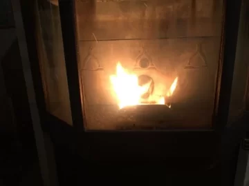

OMG I am really starting to hate my Austroflamm Pellet Stove.
Photos of the flame bright active on start up and or shut down and Lazy dark sooty tall when running in between any start up or shut down as in started up and heating the house. It will never change from that lazy state until you turn it off or start it up.
Maybe it's too hard to see in the photos.

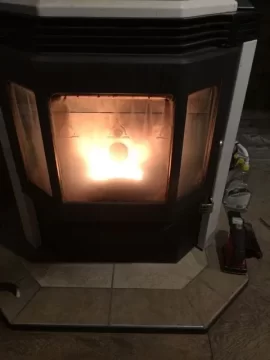

Here's mine I just did a full cleaning this afternoon running just below the first line on the knob [Hearth.com] OMG I am really starting to hate my Austroflamm Pellet Stove.[Hearth.com] OMG I am really starting to hate my Austroflamm Pellet Stove.

mine looks like that at start up then when the start up cycle is over it goes to lazy sooty :(
