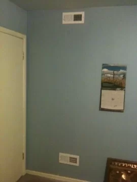

I installed 2 registers in the chase which I put in the closet of my upstairs level. The registers are to obtain some of the usable heat that the chimney pipe puts out and was staying in the chase. I placed one low intially to see if it would let out heat. The result... no heat. I added the second one yesterday and immediately, heat began pouring out of the upper hole that was cut. I have both registers in and it sets up a nice convection cycle. You can feel the draw from the bottom register and the heat out of the top. Pretty cool.
Thanks, Curious G!
-Ray

Thats the way to do it. Nice job.
Shawn
This is similar to what I have done with the chase in my bedroom, but I just have the one located at the top.
I was thinking of adding one on the bottom also to help convection, but the top one seems to put out allot of heat as it is.
Sounds like a great idea!
Guess I know what I am doing this weekend....great idea.

Good question, but I don't think that this will be an issue as this is a chimney already running inside the house and is not subject to outside temperatures. The pipe/chimney runs up the middle of my home from the finished basement, through an upstairs closet, through the attic and out the roof. I couldn't see this as being a problem thus the additional heat source. I suppose time will tell, but I have doubts about it effecting anything other than the temp in my son's room.
My son gave me some feedback tonight, and thinks that the overnight room temp was warmer than the when using the diesel furnace (leaving the furnace thermostat at 55-60 probably has something to do with that). That makes me smile, though. Thanks again, C.G.

I have not measured the temp in my son's room, but I know that it is warmer than my other kid's room, by probably about 5 degrees when I have checked on him at 11 PM. I am not burning 7/24 anymore, or I think it might be more. My other's room is about 60 at the same time. The stove burns through the night so it is getting continuous heat. It took me about about $20 and 1 hour of time to do the job and the heat so fas seems to make a difference to my son- although I don't run the furnace at night, so any heat is a difference. I am going to place one more register in the living room off the same chase so that I can direct some of the heat into the living area when I want to close off my son's room. If I did it again, I would place larger registers.
