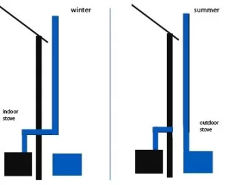

Here's the idea -- I want to hook up another stove outside on the patio directly under the existing chimney system. During the summer, I would unhook the current tee and connection to the interior stove, and hook up the exterior stove to the chimney. I would never use both stoves at the same time.

Maybe a sketch would help describe the "directly under" and "unhooking" parts better. I wonder how you plan to block off the un-used connection during the alternating seasons. ANY air leakage on either "un-used" T connections would be a VBT.

Thanks for your response. The unused section would be fully disconnected, so the chimney would be serving only one appliance at a time. There would be no threat of air leakage. I have attached a sketch of what I want to do...
thanks for your feedback!

Looks to me like unless you got a tee for the outside, there's no way you could hook them both up at the same time. I don't really see a problem with it, either. Installing a wood burning appliance in a garage, however, might be a real problem. Dunno why you want a woodstove out on the patio, but then I don't need to know that. Switching the piping over twice a year would certainly facilitate sweeping the chimney. Rick
All I'm sayin' is that based on your diagrams, the flue is going to need to be disassembled to effectively sweep it, even if it only ever stays hooked up to the inside appliance...unless there really is a Tee outside, in which case that might make it really easy for somebody to fire 'em both up someday...and that would be a bad thing. Rick
