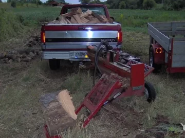

An idea that may be helpfull would be to place a 6' or 8' ladder from the ground to the top of your stack or splitter cradel. I used this method for heavy rounds I could not pick up onto my splitter, we then invested in a retrofit to the splitter. See the attached picture of our hydraulic log lift retro to a horizontial/vertical splitter, vertical splitting to me is a pain in the keester.
