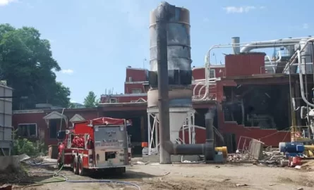

heres the pic of said mill

the big hole you see in the right hand building used to be a cinderblock wall. it blew out in a big chunc from the explosion.
"I think we should put in a window.....right here..."
