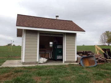

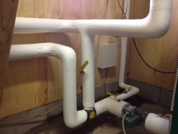

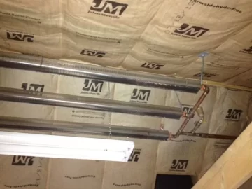

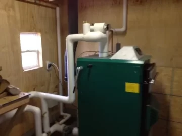

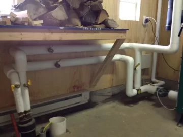

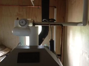

This month marks the one year point in our new house. Since moving in last October I have built a boiler shack, and installed the EKO 40 Boiler with 500 gallons of pressurized storage. Yesterday I was putting the finishing touches on the install by insulating the outside 1 1/2 copper pipe with John Mansville Microlok. Two weekends ago I finished the overheat loop. Now I can finally say there isn't anything else to do but Im sure I'll make future improvements.
