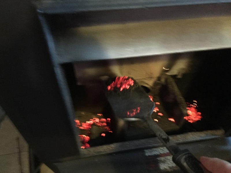

My procedure to clean the pot on my 25-PDVC without shutting down is this:
I open the hopper door to top off the pellets.
Once full, I leave the lid open so the hopper switch is up and the top auger is off and not feeding pellets.
I leave the lid open for 4-5 minutes and let the fire die down to just hot embers.

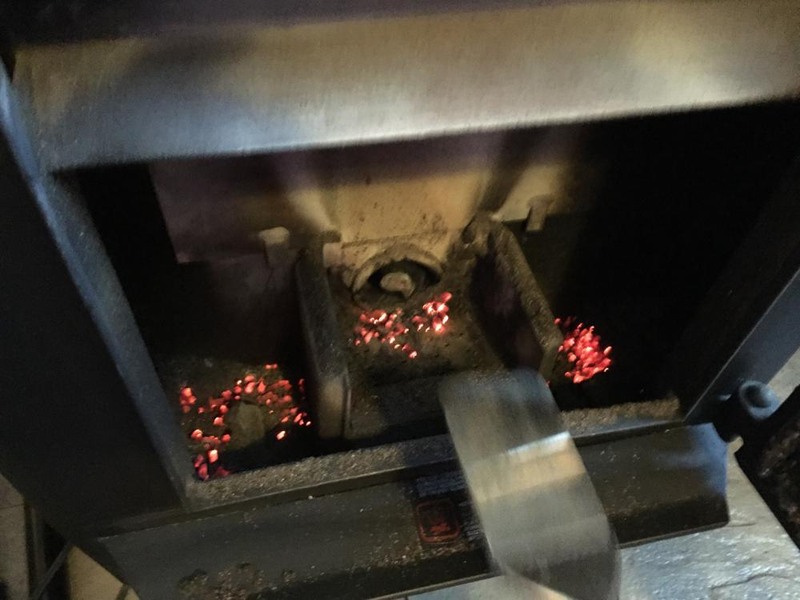

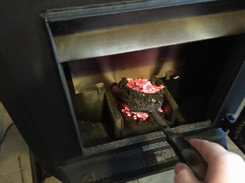

I close the hopper lid and then slowly open the front door and use a metal spatula to scoop the hot ash to the left & right leaving a few of the red-hot embers near the end of the lower auger.

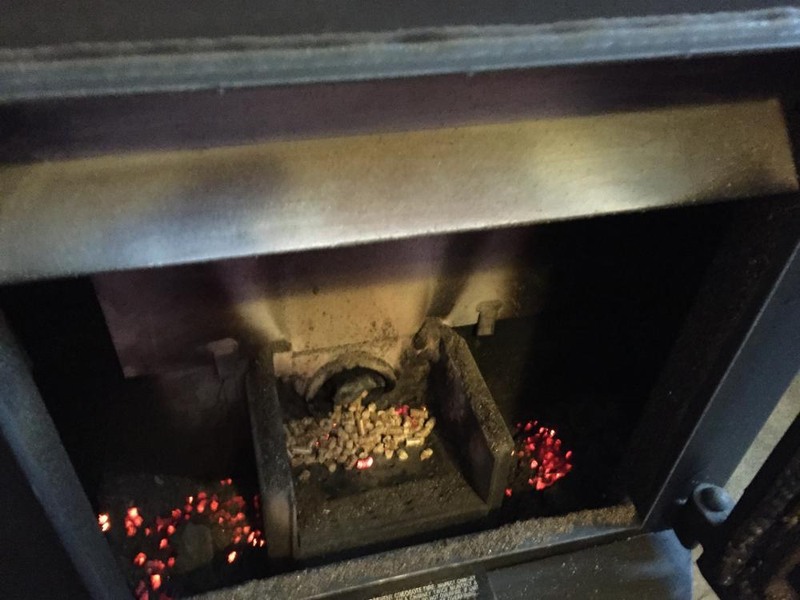

Before I close the door I toss a handful of fresh pellets into the pot on top of the red-hot embers.

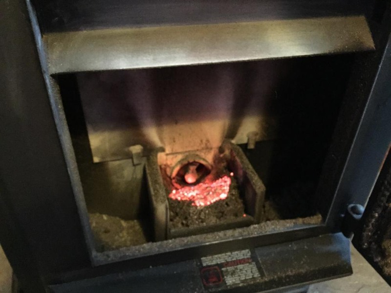

I then close the door and within 30-40 seconds, she’s back up and burning.
Within a few minutes the upper auger is caught up and is dumping new pellets into the pot.
This works great and I do it once in the morning and once in the evening when it's real cold and the stove is running 24/7.
Saturdays I do full shut down and clean out with my Powersmith Ash Vac.

Did this today and I took some photos.....
