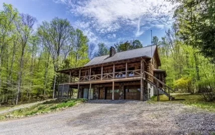

Hi -new to web & just purchased P68. Do you use another source of heat with P68? It seems we are going through lots of pellets and it is only 62 degrees. If we put it at 65-70 we use 5 bags a day. Ceiling fans on too. Just bought log home and replaced soapstone wood stove with P68. It keeps the oil off in certain zones but it's not heating like we thought. Any suggestions as I see you have a 3300 sq ft home. Thanks.

Our previous home for 20 yrs was log - wood furnace. We got in this one late so really didn't get a chance to check chinking. Looked ok but I am sure it needs some maintenance. It doesn't seem too drafty but most nights are below zero lately. 2500 sq ft with 25' cathedral ceilings in living room and 3 bedrooms. We have spent so much on oil & wood that we are hoping pellet stove would help.
With a 25 ft ceiling I suspect a lot of the heat is sitting up high at the 20ft level. In part it's what is eating the fuel up. This is a lot of cubic footage to heat, more like two 2500 sq ft homes worth. Cathedral ceilings belong in cathedrals IMO, but it is what you've got. Run the ceiling fans to do their best at moving the heat that is stratifying up there. If you can run them in reverse (blowing upward) it will feel less drafty. If there are two, try running one in reverse and one normal (blowing down) to create a convective loop.

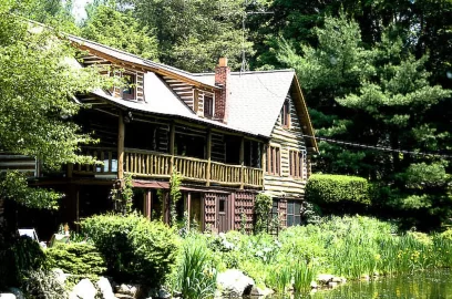

PS: Welcome. My wife grew up in a large log inn in CT. It was beautiful, but no central heat. One morning she woke up and her goldfish bowl had frozen solid. The inn's saving grace were lower, 9 ft ceilings. I put in a whopping large 175,000 btu hot air system for the new owner which made it much better, but the winter oil bills could be high.

Beautiful but not good for the fish! We are through at least 900 gal of oil and at least a cord of wood or more since Oct. It's going to be. Busy spring getting this house sealed. I wondered why the last owner never really answered me about heating. Similar to your pic. [Hearth.com] opinions on harmen p68 pellet stoves

Beautiful but not good for the fish! We are through at least 900 gal of oil and at least a cord of wood or more since Oct. It's going to be. Busy spring getting this house sealed. I wondered why the last owner never really answered me about heating. Similar to your pic. View attachment 154100
LOL, the pond is mostly for swimming, though it has some epic-sized bullfrogs.

I can tell you right now that underneath garage is not doing you any favors in the heat department. I have a one car garage and the cold coming thru the floors is amazing, even with new R19 insulation, vapor barrier and thicker sheetrock than what was originally there - plus area rugs. So not only are you battling the heat rising 25 feet, but with cold coming up from below.
