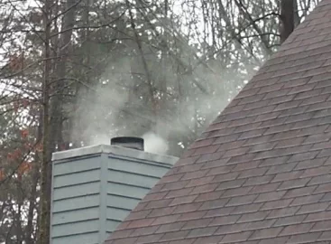

Ordinarily I burn a load or two in the evening for a little warmth and mood. Today (being a Saturday) I thought I would try ot run it all day without reloading it every 2 hours. I packed it full, let it char the logs a bit, then closed down the primary air control over the course of half an hour. Anything below 25% stops active flames. I thought I'd check out my chimney and see what kind of smoke I was getting (usually it is none). See attached.
It looks pretty white to me, slow plumes of white smoke coming out. Do you think this type of smoke promotes creosote buildup? I can open the air supply to 50% and get adequate flames and near zero smoke but then I go through logs every 2 hours. I'm trying to get a project done out in my shop without actively tending the fire all day.
The glass door lets me see that the bottom logs are glowing red on the bottom. No visible burning elsewhere and the firebox is fairly packed with an assortment of decent hardwoods.

I dunno but if I'm your neighbor I will think you are smoking up the neighborhood. As far as creosote I'm sure more would be formed but just how much is hard to tell. Need a flue thermometer to be sure. But I'm sure running it like that every once in awhile isn't going to make that big of a difference in the amount of creosote you form in the chimney.

Looks like the wood needs to char a bit longer. With a full load, this will take 15-30 minutes. Normally, if I see white smoke like this coming from the chimney it means that either my wife just threw on another log or the fire needs a little more air. The air intake control is pretty sensitive. Sometimes just a tap will make a nice difference in smoke reduction. Ideally you want slow, lazy blue-orange flames. What kind of wood was burning at this time? That will affect burn times as well, but most of us are only getting 2-4hrs per load with the 3CB. The firebox is too small for much more. However, our stove is still usually at about 350 after 4 hrs, so there is heat, just not the 500-550 heat at peak burn.
i think I've got a few pieces each of locust and poplar. I thought the poplar would burn a bit quicker,maybe produce a little more flame to help the locust along. man, I'm hoping I don't have to be that sensitive to the woods I'm burning. I just wish I could close it down more - anything with a active flames, even lazy flames, seems to only get me into the 2 hour range.

back to the original post: At times white smoke is not a good sign. Why? Because steam is also white in color.
So how does steam enter into your smoke exhaust, too much moisture in your wood. It is possible that your
wood is not a dry as you think. In a rush to damper down you are still vaporizing the wood moisture. The whiteness in
your smoke, is because it is mixing with steam. I also believe you should be controlling your initial burn with your air inlet.
I think you are rushing the dampering down. It would not hurt, probably improve your efficiency, to reduce the air.

I had done the gradual dampening down as Elk suggested - that was something he had mentioned on a previous related post. I've been using what I consider dry wood. I have enough that I don't need to burn anything else, occasionally skipping over a log that feels heavy or seems wet that somehow appears in my 'dry' stack. I've tried this before with store bought kiln dried wood with the same results, although I do recall my very first burn had flames with a 'closed' air supply because that really surprised me (I was trying to kill the fire). I've tried using an incense stick to check for leaks - none.
