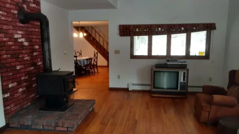

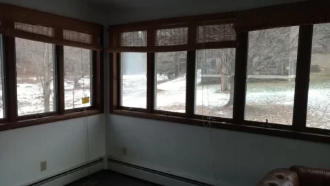

Ok, here are the pics.... i was going to use the stove as extra firepower, until there were clearance issues... and the corner i was hoping to put the bkk...
Not my tv, just in the house....just sayin...

Looks like a porch converted to indoor use. If the stove was installed here would you be able get adequate flue height at this location?
There's a roof overhead, would it make a difference if it doesn't go over the roofline of the second story though??? Over the hundreds of Bk pages I've read I can't remember...
The King will want 15' of 8" flue. As for the 2nd story that would be up to the 10-3-2 rule.
