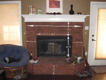

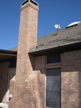

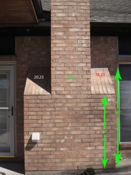

New member here - been researching feverishly over the past 6 months about replacing my prefab fireplace with something that can actually produce heat. Thought I was all squared away, but when I went to the the local supplier/installer regarding an RSF Opel 2 (maybe a 3 with gravity vents), he immediately said I would have to tear down the doghouse and chase and have them rebuilt. This is without looking at the pictures or measurements I took. So here I am asking about whether this is true or not...
Ideally, I would like to do an alcove type install with a wood burning stove (it could stick into the room a little bit, but not a whole lot :(), but I didn't think I would have the clearances necessary without doing the complete tearout and rebuild of the doghouse/chase. If it's possible without tearing everything out, please let me know :) Below are some pics with measurements. FYI, there is a gas line for starting fires - I presume this can be capped off far enough away that it wouldn't be a problem. Also, I'm pretty sure the entire inside brickwork and mantle (and maybe the wall above the mantle) does have to be torn out, so that is not a concern.

Was definitely a thought, but not sure if I have enough space to sacrifice in front of the fireplace opening - the room has all the a/v stuff in it, and the layout is pretty fixed. The old papa san chair will be moved (disposed of :) ), but I still only have 5 ft of usable space from the front of the fireplace (this would include the 16" recommended pad in front of the stove). I have no problems with having the interior brick /wall redone. I presume the stove would vent throught the existing chase (assuming I can can an appropriate chimney/liney stuffed in there). Now I'm trying to find a local installer (I don't really trust the guys I originally went to anymore).

Thanks - I talked to one of the installers for an extended period of time (edit) - he recommended a Pacific energy FP30 after seeing the pics. He siad that if I reallly wanted to do a free standing stove (thinking alderlea T5), I would have to use a T in the back, and have a door placed in the doghouse for chimney access (sweeping). Not sure what the cost would be on that... He didn't mention the possibility of using 45 degree elbows like I have seen on some of the installs here.

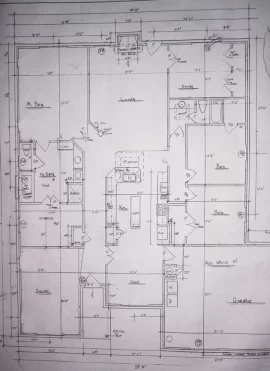

The living room is 17 by 27 ft with 10 ft ceiling, but freely communicates with the kitchen/nook area, which is another 28 feet (total about 17 wide and 55 feet long), plus another 19 by 12 ft room adjacent to the nook area (far away from the fireplace), that communicates via a hallway running parallel to the kitchen. Floorplan is below...what is labeled as living, kitchen, nook, and dining all have the same height ceiling without obstructions. the bedrooms and study have actual doorways
