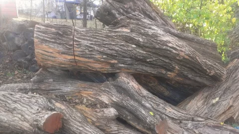

I was supposed go harvest this about a yr ago...and something happened.
So called a good friend of mine (Lumber-Jack). He wants to make a friendly wager that these hedge bottoms I let lay for about a 2 year & a half cannot be cut, without major damage to my chains, chainsaw or ego.
He swears up & down that they have now reached the stage of almost "virtual petrification"...yeah, right!
[Hearth.com] Osage Orange/Hedge Bet?
Here is pic taken the last of Dec 2012...have any of you guys encountered problems cutting or bucking downed Osage Orange after a couple of years or so?
My two saw attack mode consist of an MS390 & Sachs Dolmar 116si both with 20in bars Stihl RSC chain...and of course a couple extra chains! ;)
Thanks
Reg

Unfortunately I don't have any experience cutting hedge in any form. But, if I had to guess, I'd say it's prolly like dead Black Locust, which I find to be the toughest on my chains. I'm with you, bring a couple extra chains and you should be fine.
Reactions: ReggieT

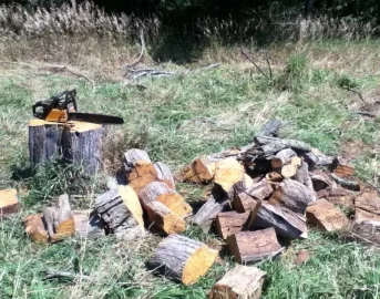

[Hearth.com] Osage Orange/Hedge Bet? Won't be a problem. I cut up a standing dead hedge tree last summer with no real problems. Probably been dead for ten years or so but still solid as concrete.
Reactions: ReggieT

Maybe invest in a good chain file Looks pretty tough to me. Dry stuff is the worst
Reactions: ReggieT
Reggie, Welcome to the Hearth.
That's nice bit of osage, but shouldn't take long to cut.
I haven't noticed any problems when cutting 'petrified' Osage. It's common for portions of an Osage to be dead as depicted Scooter's pics above, even with various states of green wood and deadwood within the same log since it decays slowly. Who knows how long parts of an osage tree might have been dead ?
Use a properly sharpened chain and you'll be fine. Even though Osage is hard, steel is much tougher. The RS chain will dull quicker than RM chain (semi-chisel) in dirty wood. I've noticed more dulling to chain when cutting low on trunks in general irrespective of species.
As dense as osage is, it splits easily. Wear gloves because osage slivers are like steel nails.

View attachment 160630 Won't be a problem. I cut up a standing dead hedge tree last summer with no real problems. Probably been dead for ten years or so but still solid as concrete.
Great job!
Man that stuff burn crazy hot & with it's own fireworks show!:eek:

You are correct sir...and thanks for the welcome. I may just grab two extra chains 1 per saw and get them in RM instead of chisel...although I've fallen in love with chisel down through yrs in all but the filthiest of wood.
I split some hedge that I'd stacked awhile back and it was still bright orange/gold inside like fresh cut!
Thanks for the great feedback...quality guys on this site...as opposed to others!;)

I have to agree with what was said above. It's not going to be easy, and it won't be nice to your chains, but it will cut.
I've cut downed, dead hedge that had all the sapwood rotted off the heartwood, it was VERY hard wood, but the saw cut it and I burned it...
That being said, it's MUCH preferred to cut it green, it cuts just like any other hardwood when green...
Bring your files with you and you will be fine.

cutting will be easy, Splitting will be a challenge. looks twisted & crotchy.
You mean to tell me there is hedge that isn't twisted and crotchy?
BTW, I've found hedge to split fairly easy in the timeframe of 3-6 weeks after cutting. When green or when really old and hard it can be tough to split sometimes...
