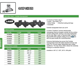

dulls a hardened steel chain (get a carbide chain).
Need some wine & cheese ?
LOL ;lol
carbide impregnated chain:

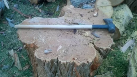

Not when they look like this:
BDB,
My 361 cut through this wearing a 20" bar, with a certain amount of authority. You'll be just fine with that 036.
HELL YEA !!!
I wish I had a stump like that in my yard to split on!! :) Could pass it down to my kids! :0
