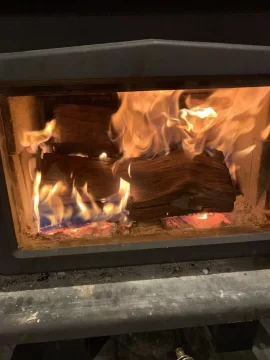

Well I can definitely say I’m pleased with how it’s running with the pipe damper installed. 3 big black walnut splits put on last night equaled a 7 hour burn! First time ever! Had coals in the morning to relight the stove before work.
Here’s the splits in question
[Hearth.com] Osburn 1600 LOVES to run

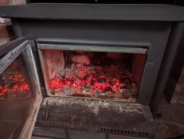

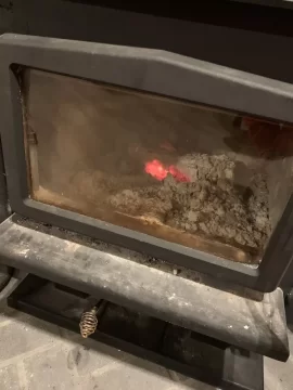

And here’s the coals I woke up to! [Hearth.com] Osburn 1600 LOVES to run

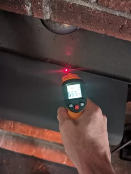

My 1600 insert loves to run on my 24' chimney too. I'm usually cruising between 650-725 STT but I can get good overnight burns. I reload around 10:30 pm and have coals at 7:30 am. For me it's all about turning down the air as early as possible and it stays in control. If I wait too long it'll run away too 750-800.

I reloaded at 10:30 pm last night with I'd say an 85% full load and at 7:30 am this is what I have for coals. 7:45 the door is closed and I'll shut the air down the first time in another 5-10 min or so then once more after that A very easy reload.

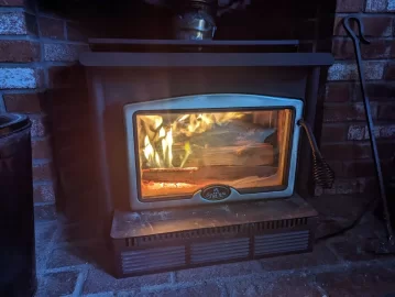

Cruising away with a medium load in since it's mild outside. It's 35::Foutside now with a high of 47 so this load will carry us through the day. A nice comfy 70 in here! It will likely get up to 72 or 73. The wife likes it toasty.
