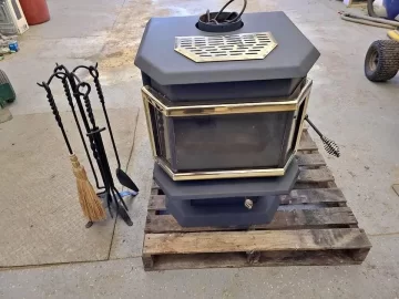

I used to have a woodstove and do all the "wood stuff" back in 2012. I'm getting ready to move to a new place and will be moving into a 1700 sq ft single story manufactured home. I've found an unused Osburn 1800 Baywood woodstove on Craigslist. Looking at the specs on it, it's rated for up to 1800 sq ft. Would this unit honestly comfortably heat a 1700 sq ft home? Appreciate your feedback.

That is the old style 1800. It's listed as 1.8 cu ft but actual useable will be more like 1.6. The Bay Wood is an E/W loader with a bay window. In our mild climate it will heat the place ok, with ~ 4-6 hr burn time on average. However, it will require fully seasoned firewood to burn will and at least 12' of flue. If you don't have firewood already, get some doug fir now and stack it top covered.
The manual is here:
The stove can be installed in a manufactured home as long as it is bolted to the floor, has an outside air connection, a proper flue system, and clearance + hearth requirements are honored. A straight-up flue is the best.
