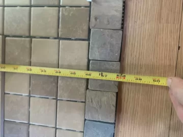

What size is your current hearth? The F45 minimum hearth size is L 44”X W30” if I understand the manual correctly.

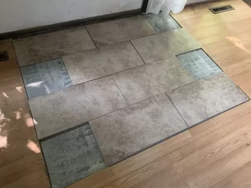

Ours is 60” w X 48” I’m just Remodelling it I’ve got rid of the ugly concrete bricks and I’m going to put down floor tiles, it’s a wood floor so I’ve got galvanized roof flashing to put down first, then cement board then the tiles

looks like your hearth should work for either stove at that size. It will be interesting to see the cost difference.
