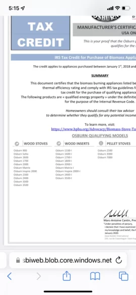

I’ve heard good things about Osburn but don’t get caught up in the manufactures numbers. Both stoves have roughly the same firebox size so will hold the same amount of BTU’s. The Osburn may be eligible for the tax credit? The Jotul is a nice stove too, love mine.

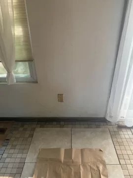

@begreen, our heritage that we are replacing had a heat shield on the stove itself which I think was about 6” or so from the wall, but I like the Osburn stoves they have great reviews and are solid made but they don’t come with a heat shield on the back which is a bit strange, so it means making the hearth bigger and further into the room to accommodate the distancing from the wall, 11.5”.
The salesman says he is trying to find out about a heat shield and he said there are metal plates that can be fixed to the wall
So I’m at the stage this weekend of looking at other stoves, Jotel technician is coming on Tuesday to talk and look, we like the reviews of the Greenville . I’ve been checking out PEt5 but they are more expensive but excellent from the reviews. And I have looked at the blaze king they seem to be good too and one of the Osburn dealer sells them but there are none in the small showroom, or regency ? I’m going to begin writing pros and cons of what we like,
I’m not too confident of building my own wall heat guard lol. But thanks for your help guys

Oh slight mistake the 11.5” is the extra hearth depth not distance from the wall

I agree it wouldn’t be too hard , I put the kitchen in but the electric outlet and the window make a metal screen more of a challenge, and if it has a blower I’m not sure of the outlet being usable ? Right now I’m thinking of choosing something else ? But thanks ( this is like choosing a car lol )

Latest update for our new stove . The Osburn dealer has got back to me about a heat shield for the 2000 and we would still have to extend the hearth forwards by 8” for the 2000 . Rather disappointing and my wife isn’t too thrilled about that so the Jotel dealer technician came out yesterday and for a Greenville the hearth is ok but he recommended another one inch
For the hearth I’m making he (Jotel ) also recommended putting down flashing first then my cement board then the ceramic tiles and photographing each stage so the inspector can see what’s been done , apparently an inspector comes to view the finished project for the 26% credit

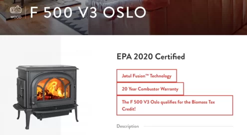

The Jotul F45 doesn't qualify, only the F500v3 qualifies for the tax credit.

I double-checked the EPA database before posting. Currently, only the Jotul F500v3 is on the tax-credit qualified list from the EPA. If the tech thinks it is, then he should be able to show you the certificate for documentation. I doubt it. Jotul would be marketing the heck out of the F45 if it qualified, like they do for the F500v3. The F45 has no such claim.
