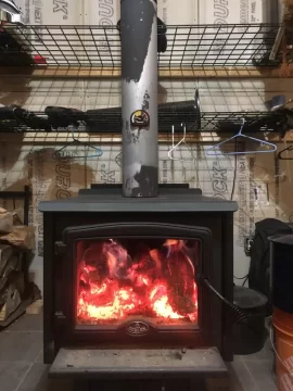

Picure of old stove with current flue.

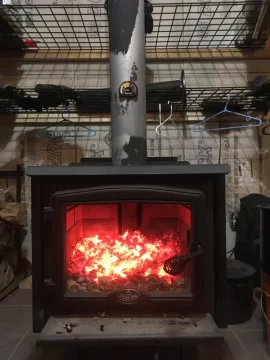

First pic of once got flue up to temp (using pipe gauge)
Second pic one hour later
Thrid pic two hours later
Is that double wall pipe with a surface thermometer on it?
First pic just closed door and primary air full open
Second pic door closed and primary at at 3/4 open
Third pic door closed and primary air still at 3/4 open
Closing the primary should result in higher stove top temps. Needing to leave the door open and the primary open at 3/4 shouldn't be necessary. If anything sounds like you would tend to overheat the pipe but if you can't shut the air then indicates a problem. which is very often attributable to wet wood.

Stove-wise the chimney seems long enough etc so I would also go about checking the installation of the burn tubes and baffle for starters.

Well in that case your temps mean nothing. If that is what you are going by you are seriously over firing the stove and chimney. And also sending a large percentage of your heat out the chimney. get a probe thermometer so you can get useful temps.

I'd take that thermometer and stick it on the stove top, in the center, right in front of the step up.
Aim for 5-6-700* STT...know that when you start to cut the air back, the STT will continue to drift upward (with dry wood) so you have to experiment with it to see when to start cutting back...500 is probably a good place to start.
