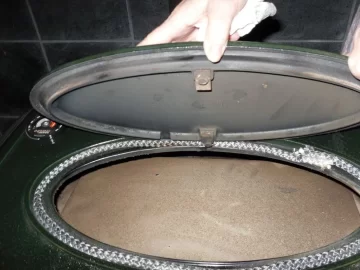

Well, we had the installer come back to make a slight correction on their install last fall and while he was here I asked him if there was a way to easier access the stove flue to vacuum out what falls down the chimney when we clean it. We don't have a T connection, we have two 45's through the damper area instead.
So - he stuck his hand up between the secondary air tubes, gave a push and lifted up the vermiculite baffle to show me how the baffle can lift up to allow vacuuming out of the flue.
Today, I cleaned the chimney for the first time this season (only got 3/4 cup, not too bad) and realized the baffle had been cemented in place and when he 'gave it a push' he cracked the baffle entirely from left to right. There is about 3/8" of vermiculite stuck to the back of the stove - and it is beginning to further crack and fall loose into the stove. Ugh!
What should I do?
1. Replace the entire baffle? I don't know if my stove shop carries this in stock and we 'were' heating 24/7....
or
2. Cement the baffle back in place and fill the cracked out areas with cement? If cement, is Rutland Furnace Cement (rated up to 2700 degrees) the correct product to use?
Suggestions welcome!
