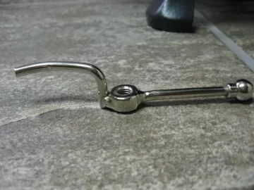

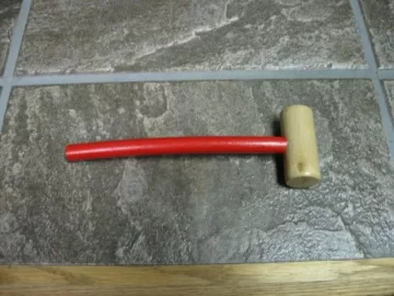

I have the 600 Firelight which had the very sticky air control lever. There is a new handle which cuts down on how hard the lever operates. The old lever has almost a 45 degree bend and tends to get (stuck) in that area. The new one has a gentle curve through out the operating range. I still find it easier to adjust the new handle with gentle taps with a wooden toy hammer from my sons block set. The attached pics are what the new handle looks like and the toy hammer for easy adjustment. As a side benny I dont have to put my gloves on to adjust the air any more. Maybe Jotul could make this an accesory item? (The wooden hammer that is) Hope this info helps.

Agree that the new handle is much nicer. I still don't know if it is a new design or a replacement part. I did get one, anyone else???

Do you take PayPal for the Jotul Adjustment Hammer ? :lol: ;-P
