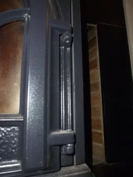

Hi- our new Oslo door is actually dragging onto the air control handle- it's hanging too low. I think it has probably been doing this from the start, but I only noticed it in the last couple of weeks. We took the door off, and heard a ping and there seems to have been a washer on one of the hinges, raising the door. (The washer fell to the floor.) But the door is not quite raised up enough to clear the air lever. If we raise the door with another washer, or a thicker one, to clear the air lever, the pin may be too high to engage the bottom part of the hinge. Was it not cast correctly? Should I do a dollar bill test to test the gasket near the hinge when it cools? I usually use the side door, and think that is why I didn't realize it right away.

In the picture, the washer is in the bottom hinge- it's silver.

My Oslo either came with or I had to install a washer on the bottom hinge . . . as mentioned . . . be sure to get a correct size replacement if needed.

I meant to put the above picture right after my original post. I found the washer and replaced it on the bottom hinge. Should it go on the top? The enamel inside the bottom hinge was worn.

The washer is in the correct place.

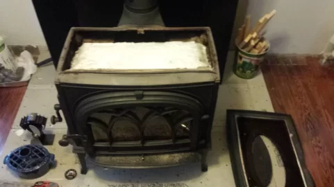

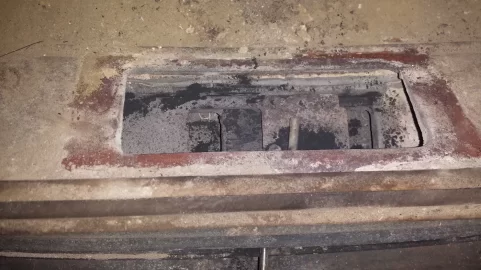

Done. New vermiculite baffle with new blanket. Cleaned and lubed air intake, moves like it's on rollers now, so easy!

Are the bolts that hold these things together anything special or can I replace them with new ones straight from the bin at the hardware store?
2 out of 3 that hold the top on are slightly bent, either from me nearly snapping them while gingerly trying to work them out or from moving the stove and lifting it from the top.
I put them back in with never seize on them so they should be easy to replace.

Technically you don't even need to bolt the top back on believe it or not . . . although I left mine attached . . . made me feel better.
