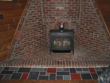

Per the request for pictures, here you go - you can see why we call our setup the "Brick Rocket" - it's a really odd configuration, but we really like the new rocket engine... The slate in front of the brick hearth is the extension that I built, 18" wide, the full length of the brick hearth, and matches / ties into the similar slate entranceway that isn't in these photos.

Wow, Thanks for posting those pics. That's quite the brick contraption you have there eh? Actually I kid. It looks great and certainly a unique feature for your house. What is the ceiling height in that room? I'd love to see some other pics of your house as it sounds like its much more interesting than mine. :-) Is the round brick chimney continued on the outside of the house to complete the brick column effect?
Anyway, thanks for sharing.

Welcome to the wonderful world of clean burning cat stoves. That is one cool looking hearth! It does look like a rocket.
Awesome setup Goose, that's very impressive. I like the older brick. When was it built?
Just BEAUTIFUL! Second that sentiment about the thermal mass of that brick stack. Once it gets hot it should retain alot of heat in that big room. The CAT stoves are definately easier for operation too, much less futzing to get and maintain the burn. What did you find with that seam? On the one I had, there was a small space on the top/side seam where the cement had fallen out. Operationally, it didn't make a big difference but when in slow burn mode the stove would puff out that seam when the CAT ignited the smoke/gasses. So nice that you are using less wood too. It seems to me the NC version is using a bit more wood than the CAT version did.

The house is lovely, or it would be if we cleaned it up more often, but not terribly practical... It was built in the mid to late 80's by a surveyor - who did lots of strange things with it. They gave the house to their daughter and built a second house next door where they avoided a lot of the mistakes they made with this one. The daughter and her husband had a messy divorce, and Mary-Anne bought it as part of that mess. The living room ceiling is 24 feet at the center, the house has a 12/12 pitch roof, which the living room follows. The rocket is about 15 feet tall where it leaves the room, but it doesn't continue outside, the chimney on the roof is fairly boring rectangular brick, about 7 feet high on the high side of the roof where it exits. (I suspect it may be crowding the 10-3-2 rule, but it drafts well at 25 feet tall.)
It is a pain in some ways - I need a 20 foot changing pole to change the lightbulbs in the ceiling fixtures. The ceiling fan went out a few years back, and in order to get up to replace it, I had to rent and erect an 18 foot scaffolding tower in the middle of the living room. When I put in low voltage wiring (Ethernet, CATV and phone to all rooms, including the bathrooms, over 6K feet of wire in the walls) I found it was the hellacious to wire - the place has FIVE different attic spaces, and I had to run wire through four of them!
The house has a much smaller square footage inside than it's footprint would suggest, in part because of the living room, and in part because of the steep roof. If it was a standard design, it would probably be about 2500 ft, instead its only about 1800.
There are essentially three sections to the house, the living room, then a combined kitchen dining area, and then a block with two bedrooms (we use as offices) and a bath. The master suite is on the second floor over the Kitchen and bedroom sections, but it's narrower because of the roof pitch.
