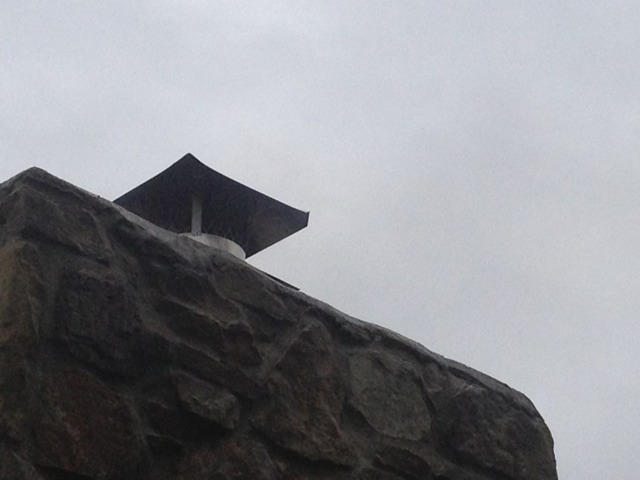

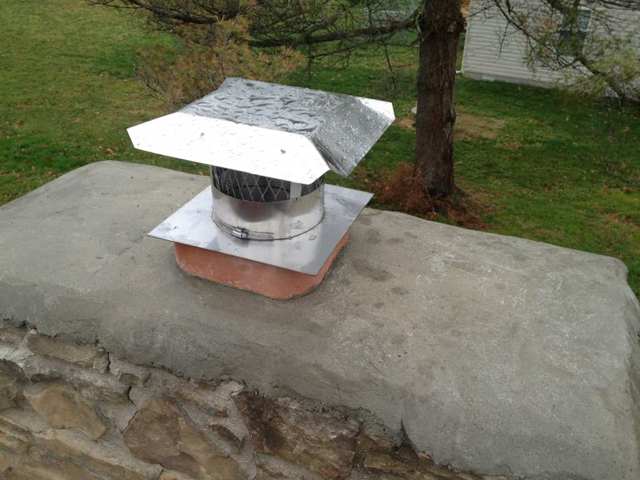

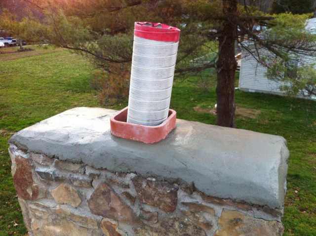

After 5 years of homeownership we finally got the chimney lined it was one of the things that was wrong when we bought the house and by wrong I mean no liner at all

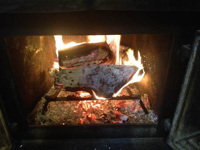

Burning
[Hearth.com] Our wood burning story

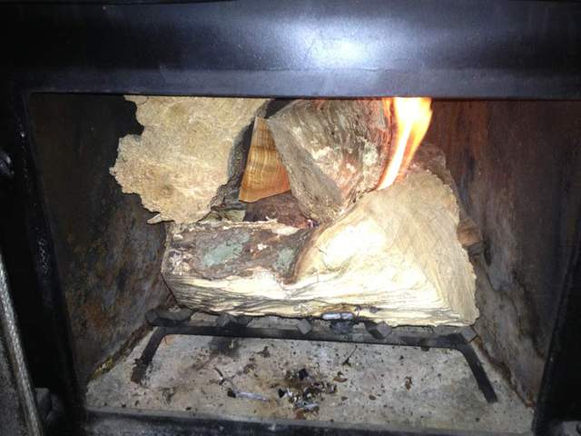

Are the wood racks in photo above necessary? It was in stove when we bought the house.
They came and did all the work (liner, new crown, new blower motor and switch, and counter flashing) 12/5/12including a new fan motor as ours was stuck. We got a cricket added to the roof too since it didn't have one

Any tips on maximizing our wood burning? We have a slight heat signature emitting from chimney with minimal smoke is this good? I presume smoke is wasted wood and inefficient burning correct?
It is burning in this photo

The clay is only about 8" tall the rest is stainless liner. I don't foresee an EPA insert in my future... I'll fin another old dinosaur if my Hutch Rebel ever goes bad but it seems unlikely from what I have read.
If you have no smoke that is good, like you said smoke is showing an inefficient burn. The grate is just there for better air flow to the fire, not necessary, more personal choice.

So I can shorten the legs then? They are about 3-4" I figure 1-2" is plenty
We live in east central Illinois and our gas and electric bill , in the summer or winter never reaches 150.00 a month. Summer time we use the air and that runs about 1.00 a day. To reply to one question no smoke is good. The racks in stove, try burning it without them and see if there is a difference.

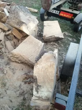

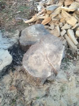

Here is some of the wood we have split this year as last resort end of the season wood.
Some of these rounds were a half Rick and up

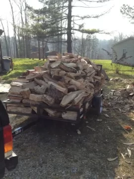

Numerous loads like this

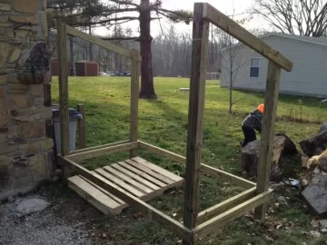

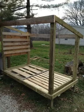

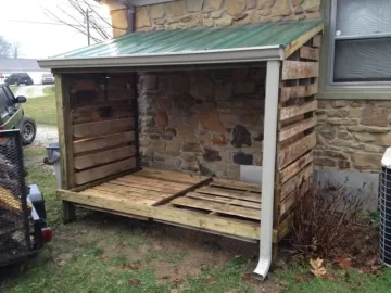

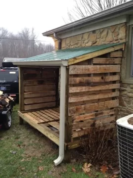

Our small wood shed
Pallet floor
Dismantled pallet siding
Finished

Nice work so far! You will be a happy guy when the winter utility bills come. The shed looks great. Very nice to keep the snow off the splits. Is the palette floor elevated? Kinda looks like it from the pics. If so how are the palettes supported?
You are tackling some big wood there with that maple. Nice wok.

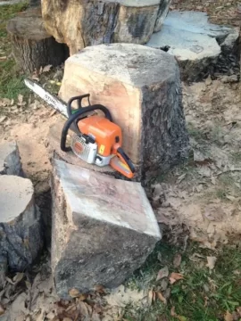

One hint : When you're chunking-up a round with a saw it's easier on the saw and operator to cut in from the edge of the round with the saw parallel to the trunk (round is on its side). Instead of dust the saw makes curly noodles (aka noodling).

Yeah so far it is elevated, I'm not sure it will stay that way it is supported by 2x4's ran the 8' width and nailed and screwed in multiple places. My bet is it will not support it but its worth a shot. It is 12" up the frame so if it doesn't work I'll look on the bright side that I can put more wood in it.
I would remove the supports and lower it down to sit on some cinder blocks. Anything you can get to support it up off the ground a few inches and keep it flat will work. Even some old bricks. The weight of the wood is likely to break your screws off. Or support it at the height it is at. Have a good one.
