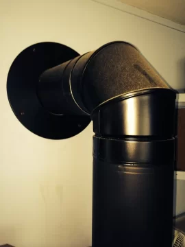

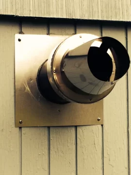

Our stove vents straight out through the wall behind the stove and terminates with no vertical rise. Works just fine.
Its generally preferred to have some vertical rise to avoid getting smoke in the house if you lose power. Its better to have the vertical inside rather then outside as the pipe will not be subjected to the cooling environment of outdoors possibly creating more buildup on the pipe. Ours goes out and up 5 ft.
Doesn't really sound like you got different answers. Contractor A told you what they typically did which is fine. Contractor B told you the absolute best way to go ( costs more too ).

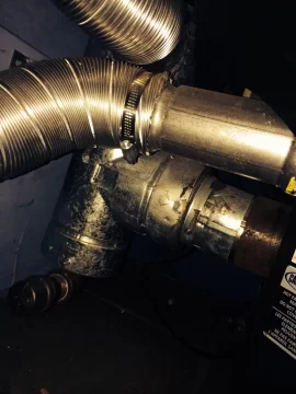

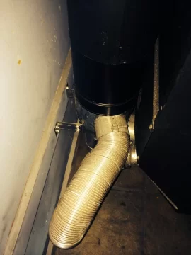

Agree going up inside the house and then out is the then out gives the best draft and easier to keep clean. The best OAK system is the Sellirk DT that warms the burn air for 10% more efficiency and works extremely well with Harman pellet stoves. I have the Selkirk up and out for the Garage p61a and the Selkirk Masonry conversion for the basement P61a
Luv that stuff especially the vacuum clean out!

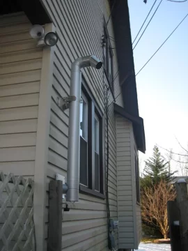

I prefer the cleanout outside...
Not like it's Polar Vortex weather all winter and too cold to clean.
but Inside rise is good also..
