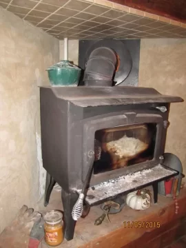

We currently heat through the winter with this (see pic). We have to use out back up propane-fueled boiler system whenever the wind blows upward of 10-15 mph out of the North/Northwest because we get smoked out every time! In central Illinois the north winds blow often during the winter, which leaves us propone bound. We have a small 1,200 sq ft home in the country with pole barn.
So, we are in the market here in the next couple weeks for an OWB system, and I'm overwhelmed. There are SOOOO many options and opinions. I'm reading the forums and reviews. We want to make an environmentally responsible choice, but I'm reading that we'll be blowing through wood at only a 41% efficiency burn tops with the top of line OWBs. I'm reading that only indoor EPA units or gasification units would guarantee the best use of wood fuel for the money we spend. I read that gasification units will really only work if the moisture of the wood is 20% or below, which normally wouldn't be an issue...but what if we ran low and had to use wood that wasnt quite seasoned? At least the run of the mill OWB would burn it with some output. I also read that common OWB units don't allow the best combustion possible due to the much chillier water jacket surrounding the chamber. Installing something in our basement would not work due to lack of access without tracking through the house.
We know we definitely are looking for an outdoor unit (due to our smokeouts and moving the mess outside), as well as looking forward to longer burn times without reloading. And we want the best efficiency (use of wood fuel) with the least environmental impact possible.
What are the best specific recommendations for our situation, in your much-more-knowledgeable opinions? I value and treasure forums like these where knowledge and experience is gathered and freely shared amongst fellow enthusiasts, veterans WBs down to rookies - and I thank you ahead of time for sharing it with me!

You are only heating 1200 sq.ft.?
I'm afraid your goals are clashing. Using an OWB to heat that small a space is likely the least efficient use of wood you could find. And it would likely lead to a lot of periods of the OWB smoldering from small heat demand - which would also make it likely have the most environmental impact.
Sounds like your current smoke/wind situation might be due to chimney issues. Might be worthwhile to consider a new or overhauled chimney & new woodstove. OWBs are expensive. And not sure how much wood you burn with the stove, or are able to put up each year - but you'd be looking at a lot more than you do now.
Why is it your getting smoked out. Id address that issue first and maybe look at a new stove. Outdoor boilers use allot of wood plus require allot of work, piping, to install. You have a relatively small house should be easy to heat with a stove

Our chimney is at a correct height though sits on the north side of our house (the only real option for the burner to sit in our home). It vents out of the burner with a 90 degree elbow then out of the house. We've tried to address the smoking for years. Our house is not tight and we open windows until the burner gets hot enough to create updraft or enough pressure to push up and out. However, we could put money down that as soon as that wind start coming out of the N/NW at more than 10-15mph, especially gusts, it'll push smoke back down and into our home. Similarly, when there is a really strong south wind (20-30mph) it'll suck the heat up and out.
With an OWB, we could be possibly be heating our garage and/or pole barn as well, though only a possibility. That would add sq. ft. to our total heating space.
Our wood supply has never been an issue; we always have 1-2+ years in surplus and that's turning some wood away.
We also are looking into something more centralized because on the cold nights, the heat from our current wood burner doesn't reach downstairs where 2 of our children sleep.

Based on your description, I think you might be best off with a new, professionally installed, wood stove and chimney liner. A vaccu-stack on top of the chimney will likely take care of your down draft issues - it is a kind of weather vane chimney cap that spins in the wind so smoke is always exhausted downwind of the chimney. Create a separate heating zone for the downstairs so the propane can help out there when the woodstove can't keep up. I would expect you could do all of this for $5000.
If you are set on a central heating boiler, stay away from an outdoor unit, you'll just make tons of smoke, use tons of wood and rot out the boiler in a few years. Warning: Shameless Plug Ahead: Tarm Biomass is offering a super low price on the Tarm Bonus Plus right now ($3500). This boiler is especially well suited to a small house like yours. Put the boiler and a 400 gallon buffer tank in the pole barn and run underground lines to the house. I would expect this project to come in in the $10,000 to $15,000 range depending on how far the pole barn is from the house, etc.

I'm also in the camp of thinking you could do better with a stove, properly installed. Have you ever described your situation to a stove professional? I wonder if a proper chimney could make your stove work famously as-is? Or if all you need is a new stove and proper chimney cap?
OWB's can be great for the right user but I think you'd spend far too much for your size home to get one installed and running.
All of the above being said, I'd strongly consider something used if you're dead set on getting a central hot water system installed. Find a solid used Central Boiler, have it inspected by a pro...and go for it.

I would add another vote to making the chimney work better with the vaccu-stack type cap and making the basement work off of propane.
That size house is on the small side to justify a wood boiler, in my opinion. That is if you are OK bringing wood to the stove now, and your only complaint is smoke blowing back.
