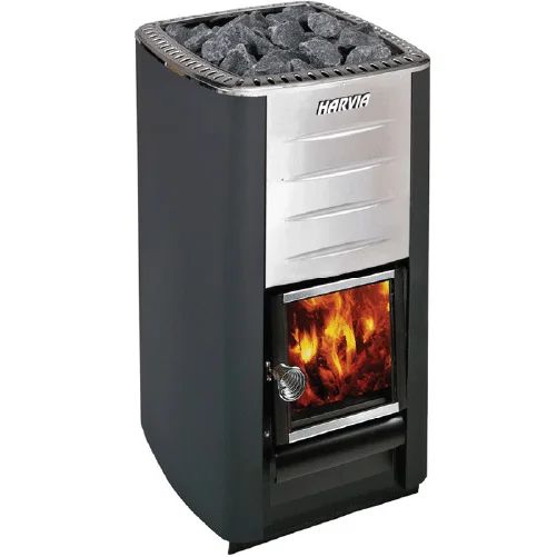

I have an itch to build a backyard mini cottage with a wood sauna. I see these heaters which I like. I'd like to get a stove that I can feed wood from the inside so that I can use it as a mini cottage as well. Some sauna's have outside stove feed, and I don't think I want that, although for just a sauna that's probably smart.
Has anyone built one?

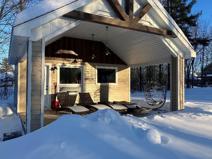

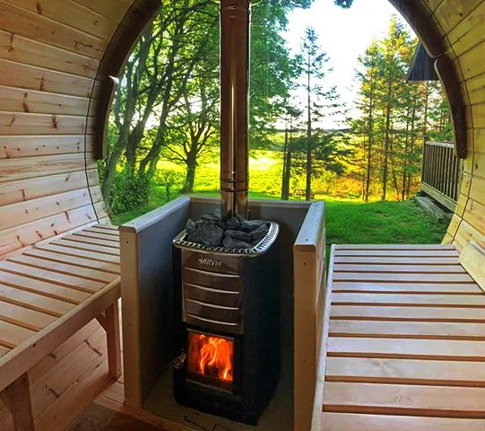

I built this one and it seats four fairly comfortably.

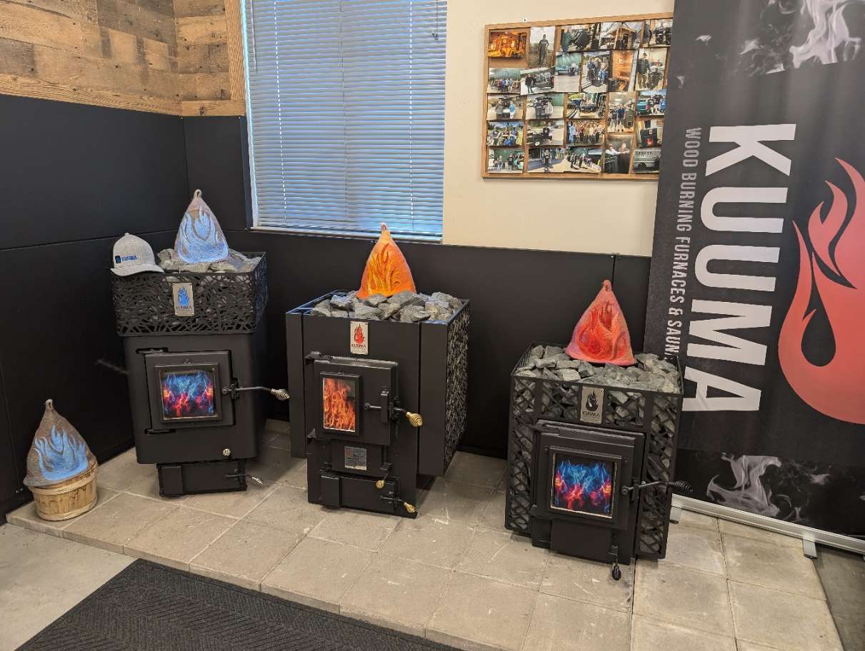

While looking, check out the Kuuma stoves too.

OK I will. I have seen that name before Kuuma. I think I need to go talk to the fire department too and see what they think. I am allowed an open fire in my backyard, but I should check about a woodstove inside a wood "shed". I can always go electric. I need to upgrade my garage feed anyway. I have a 200A panel.
